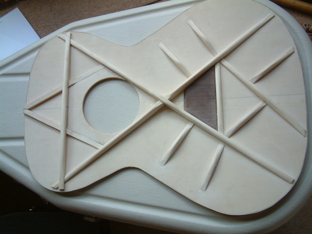

Avalon guitars uses this bracing design, and if you don't like ringing harmonics and lingering sustain, don't do it!!!
I've play an Avalon, and I know what the tone is like.. Sam Price38975.4484143518

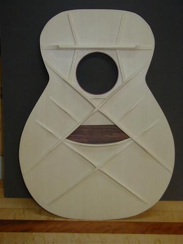

PostPosted: Fri Sep 15, 2006 2:33 am
J, I was looking for and image of my double x tops but I'm in the middle of switching computers and can't find a thing. It looks almost exactly like the one Sam posted.
I build double x tops exclusively for two years. I've since moved away from them and am building with a standard finger brace design. I found that the double x was great for a strummer and even better for someone with a heavy hand. But I found that it tightened up the top too much for a light touch and finger picker. So, in my opinion, it tightens up the to a little too much.

By the way here's a pic of my baritone bracing which happens to be a sort of variant of the double X but with the bottom X bar "broken":
Dave White38975.6579861111

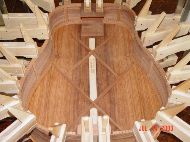

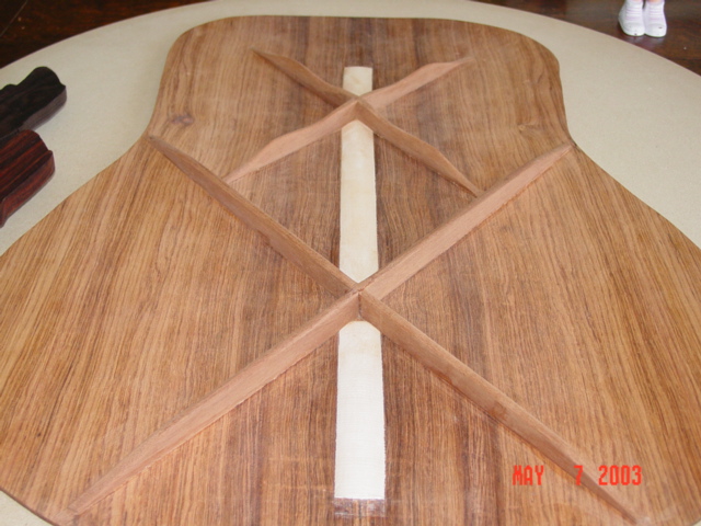

PostPosted: Sat Sep 16, 2006 2:11 am
I double-x brace my backs-sometimes. I like it. I think it makes it easier to tune the back.:
